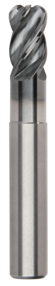

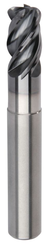

HARVI™ I • Radiused • 4 Flutes • Necked • Plain Shank • Metric
HARVI™ I Solid Carbide End Mill for Roughing and Finishing of Multiple Materials
Material Number100000053
- Versatile solid carbide end mill for steels, stainless steel, cast iron, and high temperature alloys.
- HARVI™ I solid carbide end mills cover a variety of operations, including dynamic milling.
- HARVI™ I solid carbide end mills features unequal flute spacing for chatter-free machining.
- Centre cutting for plunging and ramping operations.

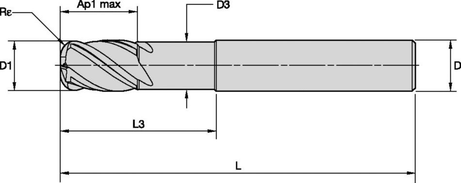

Tool Dimensions: Flute Configuration: 4
Helix Angle: 38°
Corner Style: Corner Radius
End Mill Tolerances | |||
D1 | tolerance e8 | D | tolerance h6 + / - |
≤3 | -0,014/-0,028 | ≤3 | +0/-0,006 |
-0,020/-0,038 | +0/-0,008 | ||
-0,025/-0,047 | +0/-0,009 | ||
-0,032/-0,059 | +0/-0,011 | ||
-0,040/-0,073 | +0/-0,013 |
