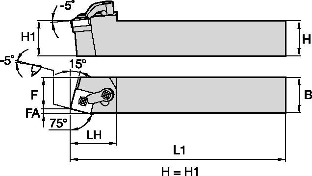

Drawings for 1102319
Material Number1102319
ISO Catalog IDMSBNL3232P15
ANSI Catalog IDMSBNL3232P15
[H] Shank Height 32 mm
[H] Shank Height 1.2598 in
[B] Shank Width 32 mm
[B] Shank Width 1.2598 in
[F] F Dimension 27 mm
[F] F Dimension 1.063 in
[L1] Tool Length 170 mm
[L1] Tool Length 6.6929 in
[LH] Head Length 35 mm
[LH] Head Length 1.378 in
[FA] F A Dimension 3.8 mm
[FA] F A Dimension 0.1496 in
Gage InsertSN..150612
Lock Pin ID Drive Size3 mm
Clamp Screw ID Drive Size3 mm
