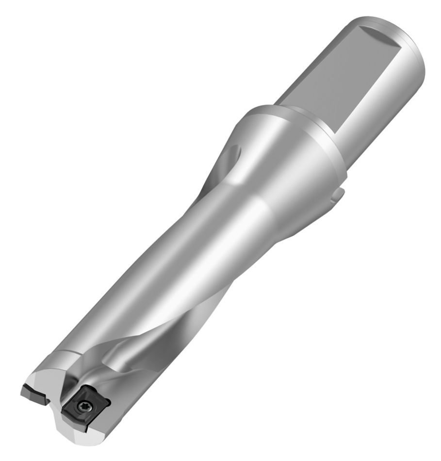

DFR Whistle Notch (WD) Shank • 3 x D
Drill Fix™ DFR™ Bodies
Material Number1799695
ISO Catalog IDDFR220R3WD32MANSI Catalog IDDFR220R3WD32M

Drawings for 1799695
[D] Adapter / Shank / Bore Diameter1.2598 in
[D1] Drill Diameter M 22 mm
[D1] Drill Diameter M 0.8661 in
[D1MAX] Drill Diameter Maximum23 mm
[D1MAX] Drill Diameter Maximum0.9055 in
[L1] Insert Gage Length 98.552 mm
[L1] Insert Gage Length 3.88 in
[L4] Maximum Drilling Depth 66 mm
[L4] Maximum Drilling Depth 2.5984 in
[L5] Drill Point Length0.755 mm
[L5] Drill Point Length0.0297 in
[LS] Shank Length 58 mm
[LS] Shank Length 2.2835 in

  • Drill Fix DFR with rectangular-shaped inserts offer high stability and feed rates at smaller sizes
  • X-offset design allows for diameter size adjustment on turning machines and optimizes tolerances on machining centers
  • Drill shipped with insert screws and Torx wrench
