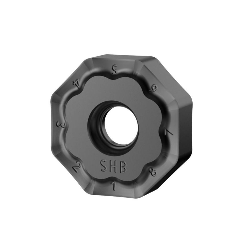

Mill 16™ • Carbide Insert • ONPX-HB • Heavy Machining
Face milling insert with sixteen cutting edges, pressed-to-size.
Material Number6001322
ISO Catalog IDONPX080620SNHBANSI Catalog IDONPX645SNHB
- K Cast Iron
| Material Number | 6001322 |
| ISO Catalog ID | ONPX080620SNHB |
| ANSI Catalog ID | ONPX645SNHB |
| Grade | KCK15 |
| [D] Insert IC Size | 20 mm |
| [D] Insert IC Size | 0.787 in |
| [S] Insert Thickness | 5.81 mm |
| [S] Insert Thickness | 0.229 in |
| [L10] Insert Cutting Edge Length | 8.284 mm |
| [L10] Insert Cutting Edge Length | 0.3262 in |
| [Rε] Corner Radius | 2 mm |
| [Rε] Corner Radius | 0.079 in |
| Average Chip Thickness [HM] | 0.175 mm |
| Average Chip Thickness [HM] | 0.0069 in |
| Cutting Edges per Insert | 16 |
- Cast Iron
KCK15
- Pressed-to-size, for lowest cost per cutting edge.
- Milling insert for cast iron and compacted graphite iron (CGI) machining.
- Numbered cutting edges for easy handling.
- Protected main cutting edge for high feed rates.
- Inserts can be loaded in cutter bodies with screw or wedge clamping.
