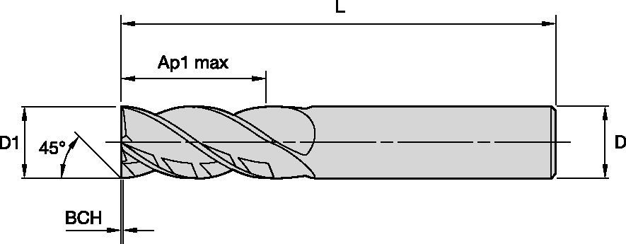

HARVI™ I TE • Smussata • 4 tagli • Codolo cilindrico • Pollici
Fresa a candela a quattro tagli HARVI™ I TE per sgrossatura e finitura che copre la più ampia gamma di applicazioni e materiali
Material Number100150031
- Versatile solid carbide end mill for steels, stainless steel, cast iron, and high temperature alloys
- HARVI™ I TE solid carbide end mills cover a variety of operations, including dynamic milling, and extreme ramping operations
- HARVI™ I TE solid carbide end mills stand for maximum metal removal, maximum productivity, maximum benefit
- HARVI™ I TE solid carbide end mills feature asymmetrical divided flutes, variable helix, twisted end face, faceted eccentric relief, and chip gashes within the flutes
- Center cutting for plunging and ramping operations

Dimensioni utensile: Configurazione del vano: 4
Codolo — Cilindrico liscio
