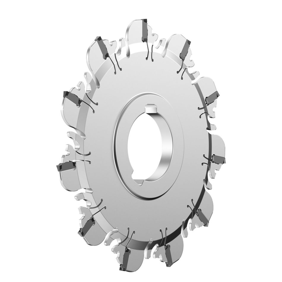

KNS® • Arbor Mount • Reinforced Body • Inch
Slot milling cutter for multiple materials.
製品番号5614861

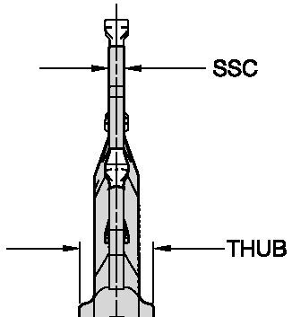

製品番号 | 5614861 |
ISO カタログ ID | KNSU050N14X12K125 |
ANSIカタログID | KNSU050N14X12K125 |
Insert Size [SSC] | 12 |
[BM] Cutting Width Minimum | 1.4 mm |
[BM] Cutting Width Minimum | 0.055 in |
[BMAX] Cutting Width Maximum | 1.9 mm |
[BMAX] Cutting Width Maximum | 0.075 in |
[D1] Effective Cutting Diameter | 127 mm |
[D1] Effective Cutting Diameter | 5 in |
[D] Adapter / Shank / Bore Diameter | 31.8 mm |
[D] Adapter / Shank / Bore Diameter | 1.25 in |
[D6] Hub Diameter | 47.6 mm |
[D6] Hub Diameter | 1.88 in |
[CDX] Radial Maximum Depth of Cut | 9.54 mm |
[CDX] Radial Maximum Depth of Cut | 0.375 in |
[L1S] Secondary Gage Length | 3.18 mm |
[L1S] Secondary Gage Length | 0.125 in |
[W1] Blade Width | 1.2 mm |
[W1] Blade Width | 0.047 in |
[THUB] Hub Thickness | 6.35 mm |
[THUB] Hub Thickness | 0.25 in |
Number of Inserts | 14 |
Gage Insert | XCP12_____ |
Weight Pounds | 0.57 |
Max RPM | 640 |

特徴と利点
- The Double-V Design of the insert and the insert pocket securely holds the insert in place, minimises radial runout, providing high slot width accuracy and high repeatability.
- A unique self-clamping mechanism ensures easy insert exchange.
- Integral hub for high accuracy and repeatability.
- Two-keyway hub design for gang slotting applications.
