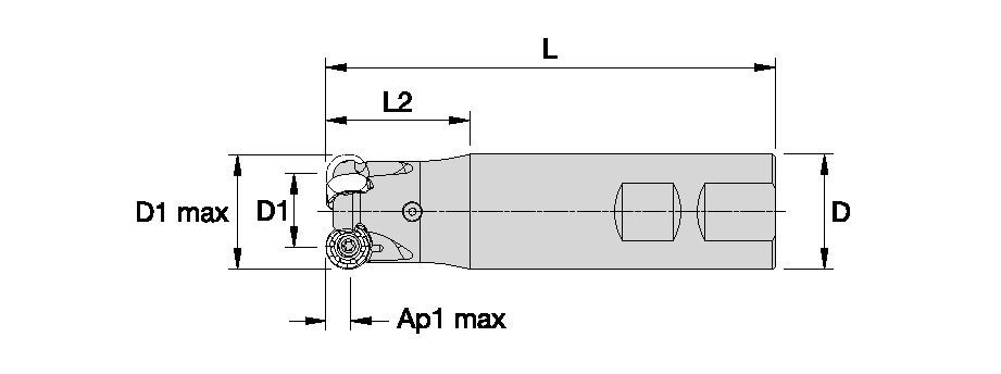

| 제품 번호 | 5152626 |
| ISO 카탈로그 ID | KDR25Z03B25RN10 |
| ASI 카탈로그 ID | KDR25Z03B25RN10 |
| [D1MAX] Maximum Cutting Diameter | 25 mm |
| [D1MAX] Maximum Cutting Diameter | 0.984 in |
| [D1] Effective Cutting Diameter | 15 mm |
| [D1] Effective Cutting Diameter | 0.591 in |
| [D] Adapter / Shank / Bore Diameter | 25 mm |
| [D] Adapter / Shank / Bore Diameter | 0.984 in |
| [L] Overall Length | 89 mm |
| [L] Overall Length | 3.504 in |
| [L1] Gage Length | 89 mm |
| [L1] Gage Length | 3.504 in |
| [LBX] Body Length Maximum | 32 mm |
| [LBX] Body Length Maximum | 1.26 in |
| [AP1MAX] 1st Maximum Cutting Depth | 5 mm |
| [AP1MAX] 1st Maximum Cutting Depth | 0.2 in |
| Number of Inserts | 3 |
| Maximum Ramping Angle | 0.6 |
| Weight Kilograms | 0.27 |
| Max RPM | 54700 |
| Gage Insert | RN_J10T3M0_N__ |

특징 및 장점
- 8개의 인덱서블 위치가 있는 양면 라운드 인서트
- 회전 방지 기능으로 높은 가공 조건 및 안정성 강화
- 포케팅, 프로파일링, 램핑 및 헬리컬 보간 성능

| 32E03R045M16RP12 | 6.0° | 1.65 | 43.95 | 52 | 64 |
| 40E04R045M16RP12 | 9.0° | 3.50 | 57.24 | 68 | 80 |
| 32A03R040B32RP12 | 6.0° | 1.65 | 43.95 | 52 | 64 |
| 32A03R040A32RP12L190 | 6.0° | 1.65 | 43.95 | 52 | 64 |
| 40A04RS90RP12 | 9.0° | 3.50 | 57.24 | 68 | 80 |
| 42A04RS90RP12 | 9.6° | 4.20 | 60.68 | 72 | 84 |
| 50A04RS90RP12 | 10.8° | 6.00 | 76.04 | 88 | 100 |
| 50A05RS90RP12 | 7.9° | 4.40 | 76.50 | 88 | 100 |
| 52A05RS90RP12 | 10.2° | 6.00 | 80.05 | 92 | 104 |
| 63A05RS90RP12 | 7.7° | 6.00 | 102.02 | 114 | 126 |
| 63A07RS90RP12 | 2.6° | 2.10 | 105.08 | 114 | 126 |
| 66A06RS90RP12 | 6.6° | 5.50 | 108.14 | 120 | 132 |
| 80A06RS90RP12 | 5.1° | 5.50 | 136.04 | 148 | 160 |
| 80A08RS90RP12 | 4.1° | 4.40 | 136.58 | 148 | 160 |
| 100B07RS90RP12 | 4.0° | 5.70 | 176.04 | 188 | 200 |
| 100B09RS90RP12 | 3.1° | 4.40 | 176.55 | 188 | 200 |
