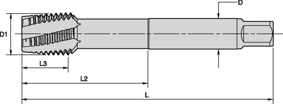

Drawings for 3868080
제품 번호3868080
ISO 카탈로그 IDT620M040X070R6HX-D1
ANSI 카탈로그 IDT620M040X070R6HX-D1
GradeKM6515
[D1-TDZ] Thread Diameter SizeM4 X 0.7
[L] Overall Length 63 mm
[L] Overall Length 2.48 in
[L3] Thread Length 10 mm
[L3] Thread Length 0.39 in
[L2] Useable Length 21 mm
[L2] Useable Length 0.83 in
[D] Adapter / Shank / Bore Diameter4.5 mm
[D] Adapter / Shank / Bore Diameter0.1772 in
[Z] Number of Flutes2
Dimension StandardDIN 371
Thread Tolerance Class ISO6HX-I
