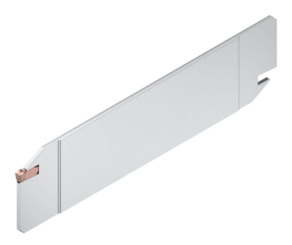

Material Number5941706
ISO Catalog IDEVBSN19G1B14
ANSI Catalog IDEVBSN19G1B14
Insert Size1B
[H] Shank Height 19 mm
[H] Shank Height .747 in
[W] Groove Width 1.4 mm
[W] Groove Width .055 in
[W1] Blade Width 1.15 mm
[W1] Blade Width .045 in
[H1] Cutting Height15.45 mm
[H1] Cutting Height.608 in
[L1] Tool Length 90.25 mm
[L1] Tool Length 3.553 in
[B] Shank Width 1.8 mm
[B] Shank Width .071 in
[CD] Cutting Depth 14 mm
[CD] Cutting Depth .551 in
  • Cut-OffCut-Off
  • O.D. Deep GroovingO.D. Deep Grooving
  • GroovingGrooving
  • For deep groove and cut-off applications
  • Universal pocket for holding all insert geometries
  • Assembly wrench supplied with blade
