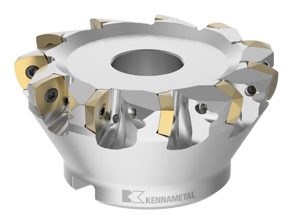

7792VXE16 Series • Shell Mill • Metric
High-Feed copy milling cutter for multiple materials.
Material Number5665957
ISO Catalog ID7792VXE16-160Z12RANSI Catalog ID7792VXE16-160Z12R
- P Steel
- M Stainless Steel
- K Cast Iron
- S High-Temp Alloys
- H Hardened Materials
- .caption
Spiral Circular
Slotting: Shoulder
Face Milling
Helical Milling
Ramping: Blank
Pocketing
Counter Boring
Plunge Milling: Ball Nose
Inclined Square End Mill
- Overview
- Application Data
- Downloads
- Spare Parts
| Material Number | 5665957 |
| ISO Catalog ID | 7792VXE16-160Z12R |
| ANSI Catalog ID | 7792VXE16-160Z12R |
| [D1MAX] Maximum Cutting Diameter | 160 mm |
| [D1MAX] Maximum Cutting Diameter | 6.2992 in |
| [D1] Effective Cutting Diameter | 134.5 mm |
| [D1] Effective Cutting Diameter | 5.295 in |
| [D] Adapter / Shank / Bore Diameter | 40 mm |
| [D] Adapter / Shank / Bore Diameter | 1.5748 in |
| [D6] Hub Diameter | 102 mm |
| [D6] Hub Diameter | 4.016 in |
| [L] Overall Length | 63 mm |
| [L] Overall Length | 2.4803 in |
| [AP1MAX] 1st Maximum Cutting Depth | 3.5 mm |
| [AP1MAX] 1st Maximum Cutting Depth | 0.1378 in |
| [Z] Number of Flutes | 12 |
