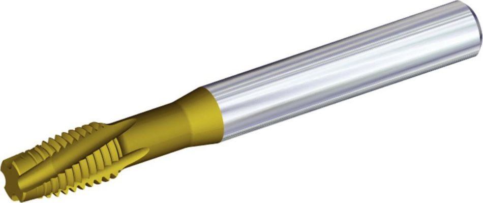

T320 • Inch • Form D Plug Chamfer
Beyond™ Solid Carbide Left-Hand Spiral-Flute, Right-Hand Cut Taps • Through Holes
Material Number3031908
ISO Catalog IDT320NC03750-16R3BXANSI Catalog IDT320NC03750-16R3BX
SC LHS/RHC Spiral Flute Tap In Threading - 3031908 - Kennametal
$339.64/each
  • Tapping: Through HoleTapping: Through Hole
  • Chamfer Form D (3.5–5)Chamfer Form D (3.5–5)
  • Class of Fit: 3BXClass of Fit: 3BX
  • HMHM
  • Manufacturer’s Specs: UNCManufacturer’s Specs: UNC
  • Tapping Helix Angle: L15°Tapping Helix Angle: L15°
Drawings for 3031908
GradeKC7542
[D1-TDZ] Thread Diameter Size3/8 - 16
[L] Overall Length 90 mm
[L] Overall Length 3.54 in
[L3] Thread Length 19.05 mm
[L3] Thread Length 0.75 in
[L2] Useable Length 33.02 mm
[L2] Useable Length 1.3 in
[D] Adapter / Shank / Bore Diameter9.525 mm
[D] Adapter / Shank / Bore Diameter0.375 in
[Z] Number of Flutes4
Thread Tolerance Class ANSI3BX
  • HMHM
KC7542
KC7542
Coated carbide, PVD — multilayer coating with TiAlN and TiN over a high-strength carbide substrate specifically designed for tap application. Use in steel up to 32 HRC and cast iron at 4x faster speeds than HSS-E-PM taps.
