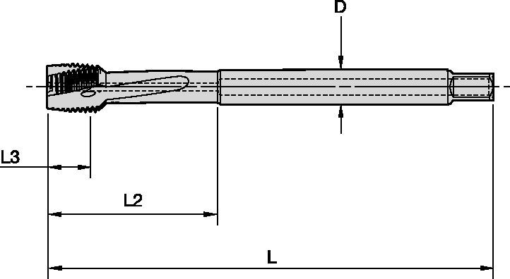

Drawings for 4028505
Material Number4028505
ISO Catalog IDT621M180X250R6HX-D6
ANSI Catalog IDT621M180X250R6HX-D6
GradeKP6525
[D1-TDZ] Thread Diameter SizeM18 X 2.5
[L] Overall Length 125 mm
[L] Overall Length 4.92 in
[L3] Thread Length 25 mm
[L3] Thread Length 0.98 in
[L2] Useable Length 58 mm
[L2] Useable Length 2.28 in
[D] Adapter / Shank / Bore Diameter14 mm
[D] Adapter / Shank / Bore Diameter0.5512 in
[Z] Number of Flutes4
Dimension StandardDIN 376
Thread Tolerance Class ISO6HX-I
