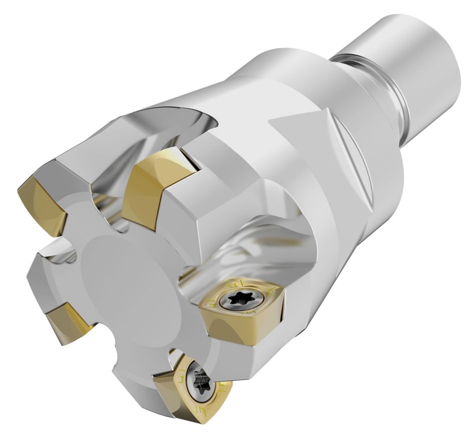

7792VXD09 Series • End Mill • Screw-On • Metric
High-Feed copy milling cutter for multiple materials.

| Material Number | 6024363 |
| ISO Catalog ID | 7792VXD09SA035Z4R43 |
| ANSI Catalog ID | 7792VXD09SA035Z4R43 |
| [D1MAX] Maximum Cutting Diameter | 35 mm |
| [D1MAX] Maximum Cutting Diameter | 1.378 in |
| [D1] Effective Cutting Diameter | 21.96 mm |
| [D1] Effective Cutting Diameter | 0.8646 in |
| [L2] Head Length | 43 mm |
| [L2] Head Length | 1.6929 in |
| [G3X] Connection Thread Size External | M16 |
| [DPM] Pilot Diameter Machine Side | 17 mm |
| [DPM] Pilot Diameter Machine Side | 0.6693 in |
| [AP1MAX] 1st Maximum Cutting Depth | 1.5 mm |
| [AP1MAX] 1st Maximum Cutting Depth | 0.0591 in |
| [Z] Number of Flutes | 4 |

- Internal coolant supply
- Positive design to support low cutting forces and applications with long overhang
