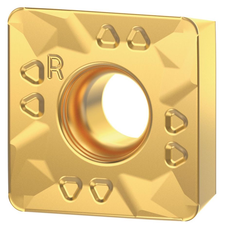

KSSM™ 10 • Carbide Insert • SPET-GB2 • Medium Machining
Shoulder and slot milling insert with four cutting edges, precision ground.

Material Number2390273
ISO Catalog IDSPET10T3PPERGB2
ANSI Catalog IDSPET3125PPER8GB2
GradeKC725M
[D] Insert IC Size10 mm
[D] Insert IC Size0.394 in
[D1] Insert Hole Size 3.4 mm
[D1] Insert Hole Size 0.1339 in
[S] Insert Thickness3.969 mm
[S] Insert Thickness0.1563 in
[L10] Insert Cutting Edge Length10 mm
[L10] Insert Cutting Edge Length0.3937 in
[BS] Corner Facet Length 2.7 mm
[BS] Corner Facet Length 0.106 in
[Rε] Corner Radius 0.8 mm
[Rε] Corner Radius 0.031 in
Average Chip Thickness [HM]0.076 mm
Average Chip Thickness [HM]0.003 in
Cutting Edges per Insert4
KC725M
KC725M
  • Single sided insert for lower power requirements.
