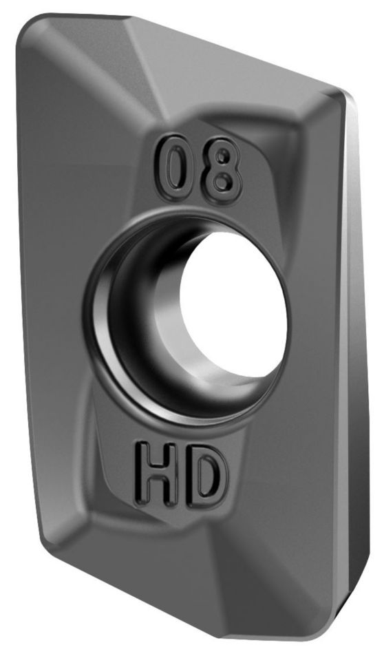

Mill 1-10™ • Carbide Insert • EDPT-HD • Heavy Machining
Shoulder milling insert with two cutting edges per insert
Material Number3642138
ISO Catalog IDEDPT10T331PDERHDANSI Catalog IDEP1031EHD
Mill 1-10 Carbide Insert - EDPT-HD - KCPK30 - EP1031EHD - 3642138 - Kennametal.com
$26.17/each
Drawings for 3642138
GradeKCPK30
[LI] Insert Length 11.516 mm
[LI] Insert Length 0.4523 in
[S] Insert Thickness3.75 mm
[S] Insert Thickness0.148 in
[W] Insert Width 6.71 mm
[W] Insert Width 0.264 in
[Rε] Corner Radius 3.1 mm
[Rε] Corner Radius 0.122 in
Average Chip Thickness [HM]0.082 mm
Average Chip Thickness [HM]0.0032 in
Cutting Edges per Insert2
KCPK30
KCPK30
Coated carbide grade with CVD multilayer (TiN/TiCN/Al2O3) and advanced Beyond™ post-coat treatment. Substrate is very tough. KCPK30 has a wide application area in general and roughing milling of steels and cast irons. Performs best dry, but can also be used wet.
  • Pressed-to-size, for lowest cost per cutting edge.
