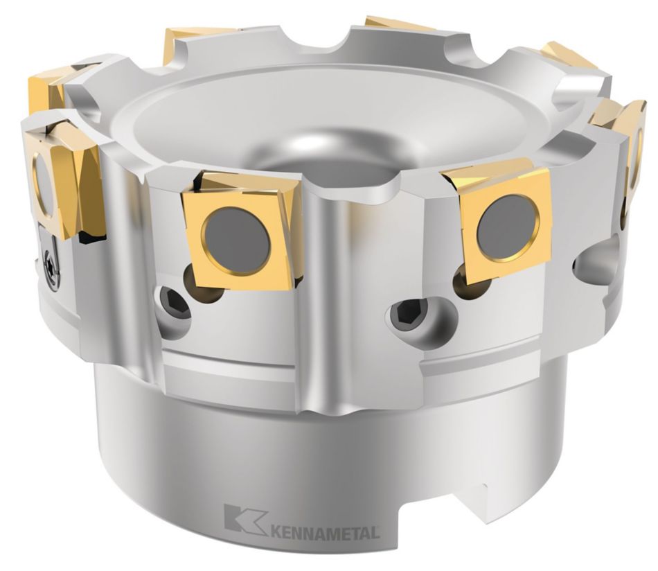

Fix-Perfect™ 90° Cast Iron Series • Shell Mill • Fixed and Adjustable Pockets • Metric
Tangential face milling cutter for cast iron machining.

  • Milling cutter for roughing and fine-finishing in cast iron and compacted graphite iron (CGI).
  • High feed rates through tangentially mounted inserts.
  • Pocket design protects non-engaged cutting edges.
  • Adjustable pockets for fine-finishing in combination with wiper inserts.
  • Insert stud clamping mechanism safely manages high RPM's.
