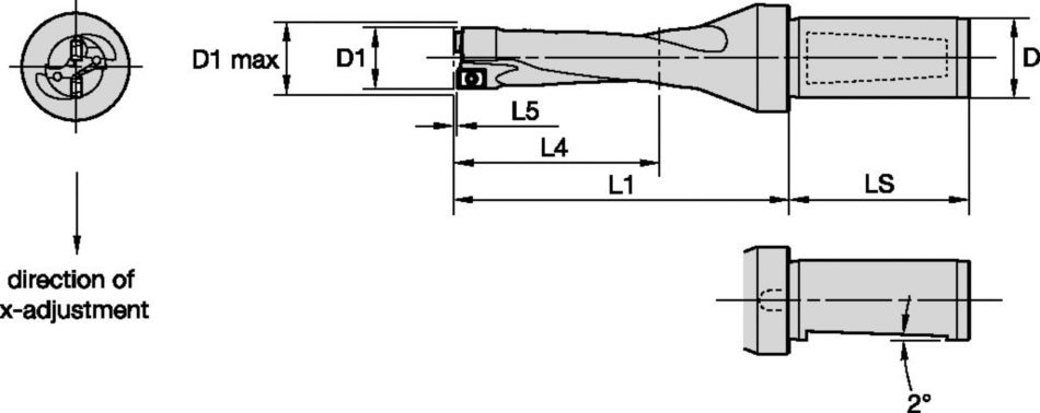

Material Number | 1799695 |
ISO Catalog ID | DFR220R3WD32M |
ANSI Catalog ID | DFR220R3WD32M |
[D] Adapter / Shank / Bore Diameter | 32 mm |
[D] Adapter / Shank / Bore Diameter | 1.259 in |
[D1] Drill Diameter M | 22 mm |
[D1] Drill Diameter M | .8661 in |
[D1MAX] Drill Diameter Maximum | 23 mm |
[D1MAX] Drill Diameter Maximum | .9055 in |
[L1] Insert Gage Length | 98.552 mm |
[L1] Insert Gage Length | 3.88 in |
[L4] Maximum Drilling Depth | 66 mm |
[L4] Maximum Drilling Depth | 2.598 in |
[L5] Drill Point Length | 0.755 mm |
[L5] Drill Point Length | .0297 in |
[LS] Shank Length | 58 mm |
[LS] Shank Length | 2.283 in |
Gage Insert | DFR0403. |
- Steel
- Stainless Steel
- Cast Iron
- Non-Ferrous
- High-Temp Alloys
- Drilling
- Drilling: Inclined Entry
- Drilling: Inclined Exit
- Drilling: X-Offset
- Drilling: Convex
- Shank - Cylindrical Whistle Notch with Drive and Flange
- Through Coolant: Radial: Indexable Drilling
- Drilling: Blind
- Chain Drilling
- Drilling: Cross-Hole Drilling
- Drilling: Half-Cylindrical Drilling
- Drilling: Corner Drilling 45°
- Drill Fix DFR with rectangular-shaped inserts offer highest stability and feed rates at smaller sizes.
- X-offset design to adjust diameter size on turning machines and optimize tolerances on machining centers.
- Drill shipped with insert screws and Torx wrench.
Warning
Warnings • Drill Fix DFR
WARNING During through-hole operations, a slug or disc is produced as the tool breaks through the workpiece. When the drill is stationary and the workpiece is rotating, this slug may be hurled from the chuck by centrifugal force. Provide adequate shielding to protect bystanders. |
Dimension
Dimensions • DFR Whistle Notch (WD) Shank
D | LS |
20 | 45 |
25 | 45 |
32 | 58 |
