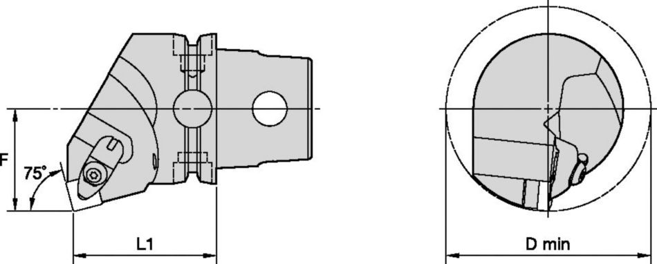

Drawings for 3738087
Material Number3738087
ISO Catalog IDKM50TSDSKNR12KC04
ANSI Catalog IDKM50TSDSKNR12KC04
[L1] Tool Length 50 mm
[L1] Tool Length 1.969 in
[F] F Dimension 35 mm
[F] F Dimension 1.378 in
[DM] Minimum Bore Diameter 70 mm
[DM] Minimum Bore Diameter 2.756 in
Gage InsertSN..120408/SN..432
Weight Kilograms0.69
Weight Pounds1.53
