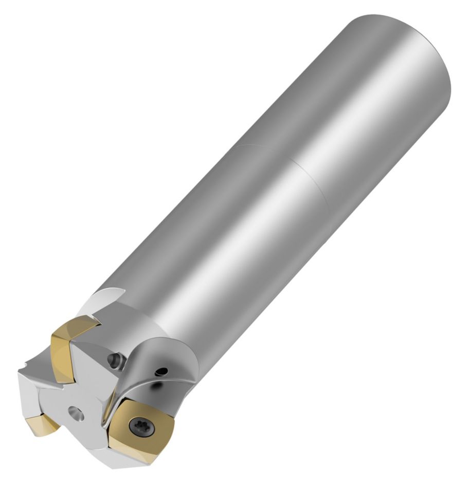

7792VXE16 Series • End Mill • Cylindrical Shank • Inch
High-Feed copy milling cutter for multiple materials.
Material Number5666415
ISO Catalog IDC7792VXE16CA2.00Z3R4ANSI Catalog IDC7792VXE16CA2.00Z3R4

| Material Number | 5666415 |
| ISO Catalog ID | C7792VXE16CA2.00Z3R4 |
| ANSI Catalog ID | C7792VXE16CA2.00Z3R4 |
| [D1MAX] Maximum Cutting Diameter | 50.8 mm |
| [D1MAX] Maximum Cutting Diameter | 2 in |
| [D] Adapter / Shank / Bore Diameter | 38.1 mm |
| [D] Adapter / Shank / Bore Diameter | 1.5 in |
| [L] Overall Length | 170.25 mm |
| [L] Overall Length | 6.703 in |
| [L2] Head Length | 102 mm |
| [L2] Head Length | 4.016 in |
| [AP1MAX] 1st Maximum Cutting Depth | 3.5 mm |
| [AP1MAX] 1st Maximum Cutting Depth | 0.138 in |
| [Z] Number of Flutes | 3 |

- Internal coolant supply.
- Positive design to support low cutting forces and applications with long overhang.
