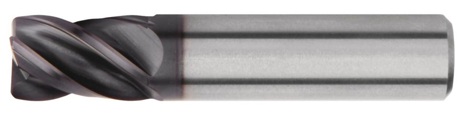

  • Tool Dimensions: Flute Configuration: 4Tool Dimensions: Flute Configuration: 4
Drawings for 4169826
Material Number4169826
ISO Catalog IDUEDE0375K4AH
ANSI Catalog IDUEDE0375K4AH
GradeKC643M
Adapter Style Machine SideWeldon Short
[D1] Effective Cutting Diameter9.52 mm
[D1] Effective Cutting Diameter0.375 in
[D] Adapter / Shank / Bore Diameter9.52 mm
[D] Adapter / Shank / Bore Diameter0.375 in
[AP1MAX] 1st Maximum Cutting Depth12.3 mm
[AP1MAX] 1st Maximum Cutting Depth0.4844 in
[L3] Usable Length12.303 mm
[L3] Usable Length0.4844 in
[L] Overall Length 50.8 mm
[L] Overall Length 2 in
[BCH] Corner Chamfer Width 0.4 mm
[BCH] Corner Chamfer Width 0.016 in
[Z] Number of Flutes4
KC643M
KC643M
Coated fine-grain grade with PVD multilayer (AlTiN). KC643M™ is a very thin and hard PVD coating particularly suited for cutting steel, cast iron, stainless steel (wet), and titanium (wet). This grade can be used for materials with hardness up to 52 HRC.
  • Economic solid carbide end mill with short style shanks, saving expensive carbide.
  • Not recommended for reconditioning.
  • Extremely stable cutting conditions due to short design.
  • Center cutting for plunging and ramping operations.
  • Unequal flute spacing for chatter-free machining at highest feed rates.
