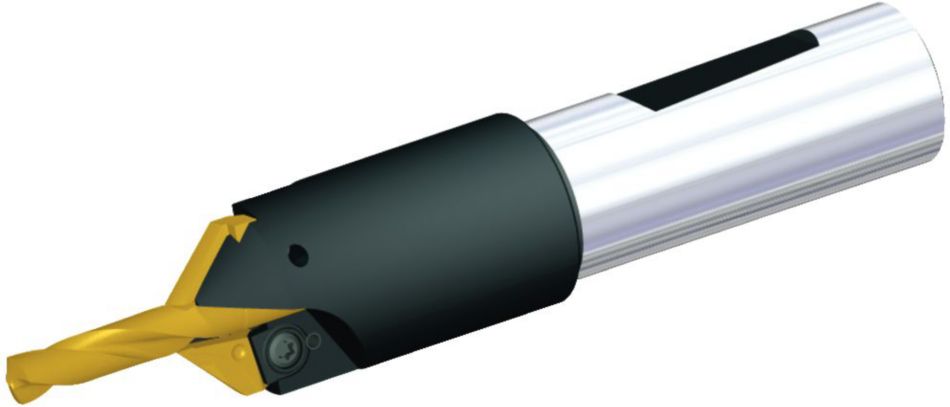

SEFAS 2° Whistle Notch (WN) • for use with Metric Drills
SEFAS™ Bodies

Counter Sinking/ Stroke Chamfering
Drilling - Through Coolant

| Material Number | 1191058 |
| ISO Catalog ID | 3.37120R732 |
| ANSI Catalog ID | 3.37120R732 |
| [D1] Drill Diameter M | >10 mm |
| [D1] Drill Diameter M | >0.394 in |
| [D1MAX] Drill Diameter Maximum | 12 mm |
| [D1MAX] Drill Diameter Maximum | 0.472 in |
| [D] Adapter / Shank / Bore Diameter | 32 mm |
| [D] Adapter / Shank / Bore Diameter | 1.2598 in |
| [D4] Mount Bore Diameter | 12 mm |
| [D4] Mount Bore Diameter | 0.472 in |
| [D5] Maximum Body Diameter | 38 mm |
| [D5] Maximum Body Diameter | 1.496 in |
| [L] Overall Length | 133 mm |
| [L] Overall Length | 5.236 in |
| [LS] Shank Length | 62 mm |
| [LS] Shank Length | 2.4409 in |
| [V] Adjustment Range | 21 mm |
| [V] Adjustment Range | 0.827 in |
| Gage Insert | 3.42807. |

- Drilling, chamfering, and countersinking in one tool when applying the SEFAS combination drilling system.
- Drill body shipped with all screws, clamps, and wrenches.
