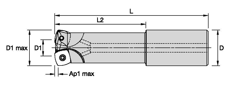

Drawings for 5659564
Material Number5659564
ISO Catalog IDC7792VXE16CA1.50Z2R4
ANSI Catalog IDC7792VXE16CA1.50Z2R4
[D1MAX] Maximum Cutting Diameter37.9 mm
[D1MAX] Maximum Cutting Diameter1.4921 in
[D] Adapter / Shank / Bore Diameter38.1 mm
[D] Adapter / Shank / Bore Diameter1.5 in
[L] Overall Length 170.25 mm
[L] Overall Length 6.7028 in
[L2] Head Length 102 mm
[L2] Head Length 4.0157 in
[AP1MAX] 1st Maximum Cutting Depth3.5 mm
[AP1MAX] 1st Maximum Cutting Depth0.138 in
[Z] Number of Flutes2
