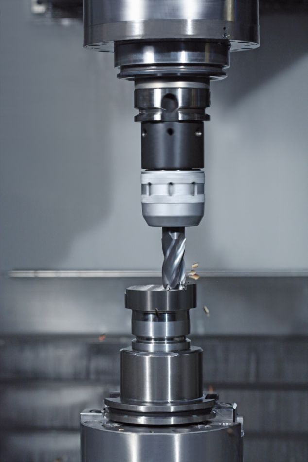

Improving your machining performance with higher feeds and speeds contributes to increased productivity, but choosing the right toolholder plays a critical role in your success. Consider factors such as machine spindle type, cutting application, horsepower, thrust, material, and desired cutting parameters when selecting the appropriate toolholder.
Some standard and advanced toolholders include:
Hydraulic Chucks: Through hydraulic pressure to tighten the tool securely, hydraulic chucks are especially effective at dampening vibrations and absorbing cutting forces during machining. Hydraulic holders are well-suited for precision work and at high speeds. They can handle both roughing and finishing tasks with exceptional performance.
Kennametal’s HydroForce™: HydroForce is a hydraulic chuck that offers the highest accuracy, clamping forces, and provides excellent dampening qualities. The HydroForce technology minimizes runout, improves tool life, and enhances cutting performance. The shorter projection length and thicker front wall cross-section result in high rigidity. They can also be used for long-reach applications and narrow operating conditions.
Shrink Fit Holders: With high clamping forces, low tool deflection, and stability at longer tool lengths, shrink fit toolholders offer a good surface finish during higher feed milling applications. They are designed to grip the cutting tool through a process called thermal expansion. As the shank cools and contracts after being heated, it creates a powerful clamping force on the tool.
High-Performance Milling Chucks (HPMC) or Milling Chucks: Offering excellent rigidity and tool concentricity for heavy-duty and high-performance jobs, milling chucks use a sleeve or end mill reducer holder to secure the tool in place. They offer superior gripping force and vibration dampening, resulting in enhanced surface finishes and increased metal removal.
ER Collets: Widely used for holding round shank cutting tools, ER Collets are known for their good gripping strength and flexibility for light-medium duty drilling, milling, and tapping. They are available in different sizes and can be identified with codes such as ER32 or ER40, which corresponds with their system size.
Whether you choose traditional options like ER collet chucks and milling chucks or advanced toolholding technologies like shrink fit holders, hydraulic holders, or Kennametal’s HydroForce, investing in high-quality toolholders will undoubtedly enhance your machining processes and lead to superior outcomes.
Understanding the Spindle
The spindle is an essential component of any machining center. It holds the toolholder and rotates the cutting tool at high speeds. When choosing a toolholder, compatibility with your machine's spindle and specifications are vital.
Several types of spindle connections exist, with the most common ones being:
Steep taper connections such CAT and BT styles are popular connection types that use a flange and retention knob for secure attachment. CAT (V-flange) is more prevalent in the United States, while BT (MAS) is widely used in Asia and Europe. These connections offer high rigidity and are common in milling and machining centers.
Taper-face steep taper connection types such as CVKV are similar to CAT and BT styles but are more rigid and can be run faster. They feature tapers and have better face contact with the spindle surface to maintain accuracy.
HSK (Hollow Shank Taper) offers an advanced spindle connection system designed for high-speed machining and complex milling operations. It features a hollow shank and a set of clamping segments that provide excellent stability, balance, and concentricity.
