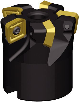

Beyond BLAST™ KSSM • Shell Mill • Inch
Copy milling cutter for multiple materials.

[D1MAX] Maximum Cutting Diameter50.8 mm
[D1MAX] Maximum Cutting Diameter2 in
[D1] Effective Cutting Diameter28.82 mm
[D1] Effective Cutting Diameter1.135 in
[D] Adapter / Shank / Bore Diameter19.07 mm
[D] Adapter / Shank / Bore Diameter0.75 in
[D6] Hub Diameter 46 mm
[D6] Hub Diameter 1.811 in
[L] Overall Length 44.45 mm
[L] Overall Length 1.75 in
[AP1MAX] 1st Maximum Cutting Depth1.65 mm
[AP1MAX] 1st Maximum Cutting Depth0.065 in
Number of Inserts5
Max RPM22900
Gage InsertSE_X443AE_N7___
Weight Pounds0.81
  • Face MillingFace Milling
  • 3D Profiling3D Profiling
  • PocketingPocketing
  • Use PCT technology, coolant through the insert.
  • Engineered to provide the maximum performance in titanium machining.
  • Pocketing, ramping, plunging, and helical interpolation capabilities.
