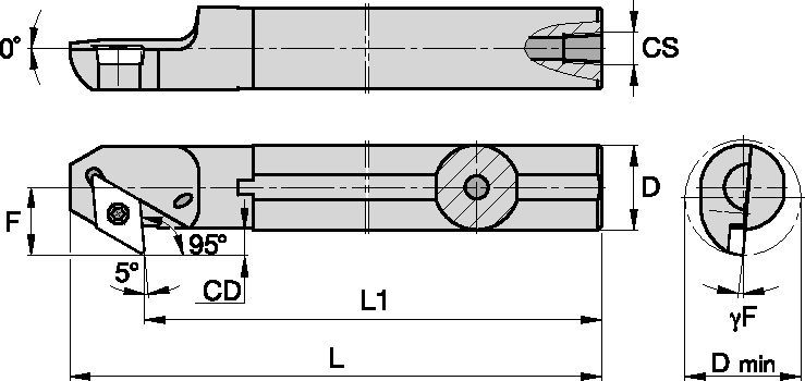

Drawings for 1328637
Material Number1328637
ISO Catalog IDA12SSDXCR3
ANSI Catalog IDA12SSDXCR3
[D] Adapter / Shank / Bore Diameter19.05 mm
[D] Adapter / Shank / Bore Diameter0.75 in
[DM] Minimum Bore Diameter 24.892 mm
[DM] Minimum Bore Diameter 0.98 in
[F] F Dimension 14.275 mm
[F] F Dimension 0.562 in
[L1] Tool Length 254 mm
[L1] Tool Length 10 in
[L] Overall Length 270.002 mm
[L] Overall Length 10.63 in
[CD] Cutting Depth 4.75 mm
[CD] Cutting Depth 0.187 in
[CS] Coolant Supply Size1/8-27 NPT
Gage InsertDC..3252
Insert Screw ID Drive SizeT15
