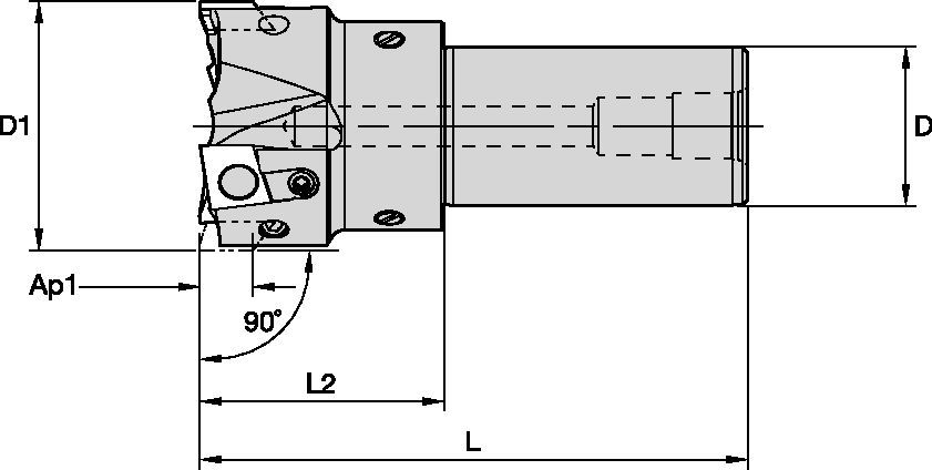

Material Number | 1758580 |
ISO Catalog ID | 50A03R049A32PBG15S3WHPM |
ANSI Catalog ID | 50A03R049A32PBG15S3WHPM |
[D1] Effective Cutting Diameter | 50 mm |
[D1] Effective Cutting Diameter | 1.968 in |
[D] Adapter / Shank / Bore Diameter | 32 mm |
[D] Adapter / Shank / Bore Diameter | 1.259 in |
[L] Overall Length | 110 mm |
[L] Overall Length | 4.33 in |
[L2] Head Length | 49 mm |
[L2] Head Length | 1.929 in |
[AP1MAX] 1st Maximum Cutting Depth | 9.5 mm |
[AP1MAX] 1st Maximum Cutting Depth | .38 in |
Number of Inserts | 3 |
Number of Adjustable Inserts | 3 |
Weight Kilograms | 0.83 |
Max RPM | 25465 |

- Produces excellent finish and flatness.
- All pockets are adjustable.
- First choice for high-speed machining.
