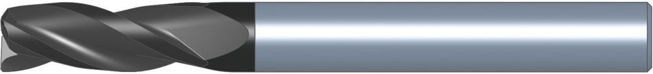

GOmill™ GP • Square End • 3 Flutes • Plain Shank • Inch
General Purpose Solid Carbide End Mill
Material Number6143947
ISO Catalog ID3SE0188IX100AANSI Catalog ID3SE0188IX100A

  • Tool Dimensions: Flute Configuration: 3Tool Dimensions: Flute Configuration: 3
Drawings for 6143947
GradeKC633M
[D1] Effective Cutting Diameter4.763 mm
[D1] Effective Cutting Diameter0.1875 in
[D] Adapter / Shank / Bore Diameter4.763 mm
[D] Adapter / Shank / Bore Diameter0.1875 in
[AP1MAX] 1st Maximum Cutting Depth25.4 mm
[AP1MAX] 1st Maximum Cutting Depth1 in
[L] Overall Length 101.6 mm
[L] Overall Length 4 in
[Z] Number of Flutes3
KC633M
KC633M
Coated carbide grade with PVD multilayer coating. KC633M™ is designed for dry milling most types of material, apart from the hardened variety. This grade is characterized by high hardness and wear resistance. It provides outstanding protection for solid carbide tools against cratering and abrasion.
  • Solid carbide end mill with excellent cost-benefit ratio
  • Eccentric relief increases cutting edge stability for long tool life and high surface quality
  • Eccentric relief eases regrinding and reduces reconditioning cost
