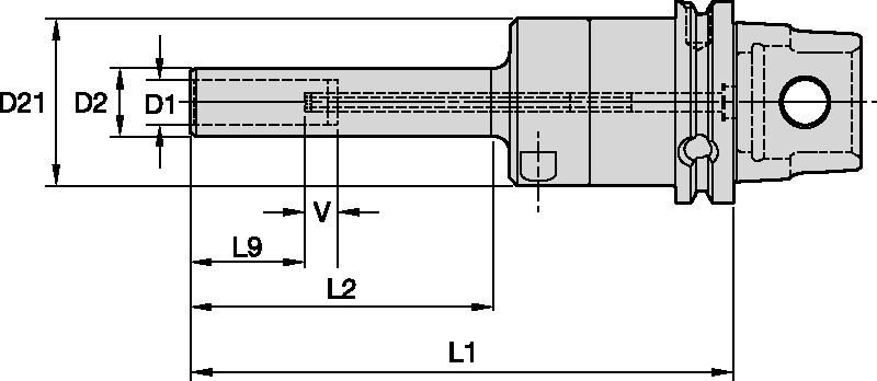

Drawings for 3055514
Material Number3055514
ISO Catalog IDKM63XMZHCSL12170MY
ANSI Catalog IDKM63XMZHCSL12170MY
[D1] Adapter / Shank / Bore Diameter12 mm
[D1] Adapter / Shank / Bore Diameter0.473 in
[D2] Body Diameter 1 Workpiece Side 19.5 mm
[D2] Body Diameter 1 Workpiece Side 0.767 in
[D21] Body Diameter 2 Workpiece Side44.45 mm
[D21] Body Diameter 2 Workpiece Side1.75 in
[L1] Gage Length170 mm
[L1] Gage Length6.693 in
[L2] Usable Length 95 mm
[L2] Usable Length 3.74 in
[L9] Clamping Length 36 mm
[L9] Clamping Hole Length 1.417 in
[V] Adjustment Range 10 mm
[V] Adjustment Range 0.394 in
Actuation Screw ID Drive Size5 mm
Stop Screw ID Drive Size2.5 mm
Weight Kilograms1.4
