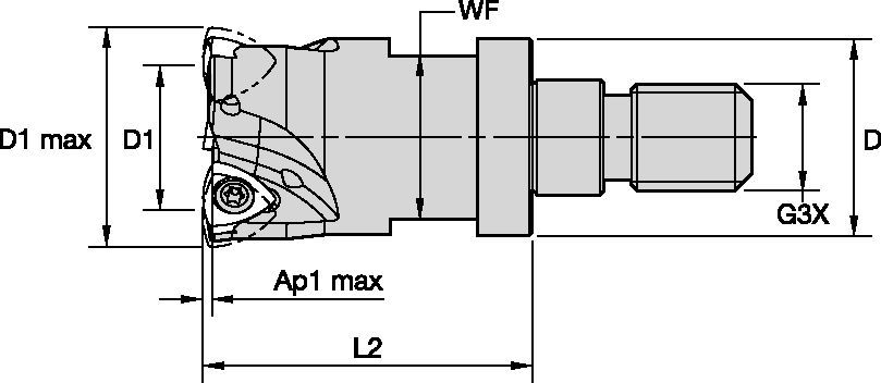

Screw-On End Mills • DM-MSO • WPGX03... • Inch
Screw-On End Mills
Material Number100003751
- Engineered to use with small machines and/or components using high-feed milling strategies.
- Fine-pitch cutters boost productivity; able to run up to 0,05 IPT.
- Pocketing, ramping, and helical interpolations.
- First choice above 3 x D applications.
Helical Milling
Plunge Milling
Ramping: Blank
Slotting: Ball Nose
Side Milling/Shoulder Milling: Ball Nose
3D Profiling
Shank - Screw-On
Milling - Through Coolant
Pocketing
