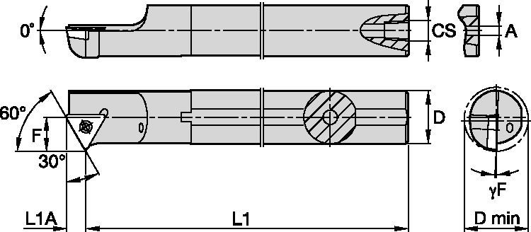

Drawings for 1098216
Material Number1098216
ISO Catalog IDA12MSTWPR11
ANSI Catalog IDA12MSTWPR11
[D] Adapter / Shank / Bore Diameter0.472 in
[DM] Minimum Bore Diameter 16 mm
[DM] Minimum Bore Diameter 0.63 in
[F] F Dimension 9 mm
[F] F Dimension 0.354 in
[L1] Tool Length 150 mm
[L1] Tool Length 5.906 in
[A] Coolant Hole Diameter 4 mm
[A] Coolant Hole Dia 0.157 in
[CS] Coolant Supply Size1/16-27 NPT
Gage InsertTP..110204
Insert Screw ID Drive SizeT7
