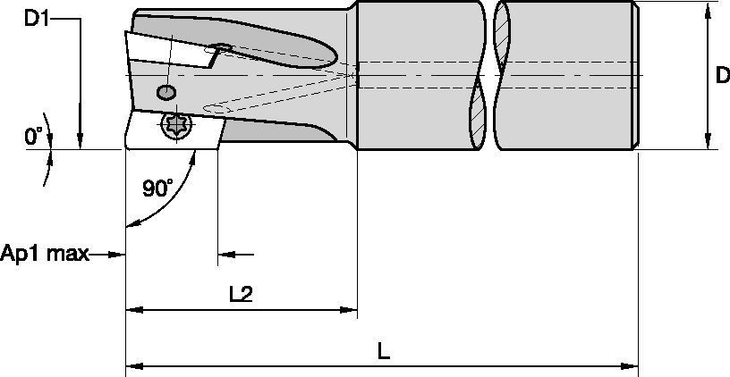

Material Number | 5903140 |
ISO Catalog ID | M1D150E1403C125L1000 |
ANSI Catalog ID | M1D150E1403C125L1000 |
[D1] Effective Cutting Diameter | 38.1 mm |
[D1] Effective Cutting Diameter | 1.5 in |
[D] Adapter / Shank / Bore Diameter | 31.74 mm |
[D] Adapter / Shank / Bore Diameter | 1.25 in |
[L] Overall Length | 254 mm |
[L] Overall Length | 10 in |
[L2] Head Length | 57.15 mm |
[L2] Head Length | 2.25 in |
[AP1MAX] 1st Maximum Cutting Depth | 14.3 mm |
[AP1MAX] 1st Maximum Cutting Depth | 0.56 in |
Number of Inserts | 3 |
Maximum Ramping Angle | 5.2 |
Weight Pounds | 3.08 |
Max RPM | 29600 |
