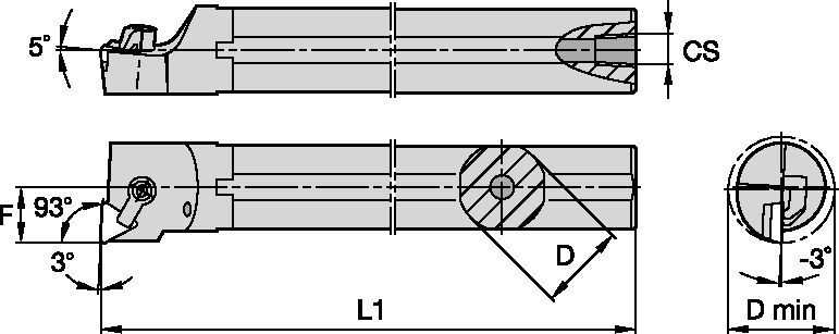

Drawings for 1098060
Material Number1098060
ISO Catalog IDA20QCTUPL11
ANSI Catalog IDA20QCTUPL11
[D] Adapter / Shank / Bore Diameter20 mm
[D] Adapter / Shank / Bore Diameter0.787 in
[DM] Minimum Bore Diameter 25 mm
[DM] Minimum Bore Diameter 0.984 in
[F] F Dimension 13 mm
[F] F Dimension 0.512 in
[L1] Tool Length 180 mm
[L1] Tool Length 7.087 in
[L2] Head Length 33.39 mm
[L2] Head Length 1.315 in
[A] Coolant Hole Diameter 4 mm
[A] Coolant Hole Dia 0.157 in
[CS] Coolant Supply Size1/8-27 NPT
Gage InsertTP..110304
Clamp Screw ID Drive Size2.5 mm
