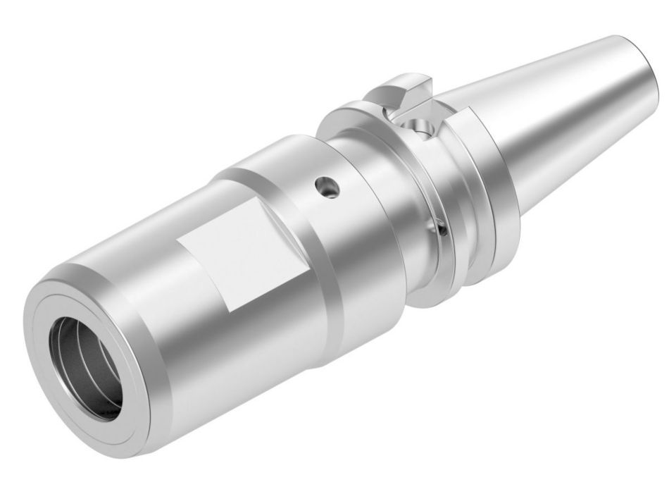

Hydraulic Chuck • BT40-B/AD • ST-Line • Metric
Hydraulic Chuck for structural steel drilling with KSEM ST-Line drill bodies
Material Number7226169
ISO Catalog IDBT40BHCP16190MANSI Catalog IDBT40BHCP16190M
Hydraulic Chuck for structural steel drilling with KSEM ST-Line drill bodies - 7226169 - Erickson
$782.27/each
    Drawings for 7226169
    [D1] Adapter / Shank / Bore Diameter16 mm
    [D1] Adapter / Shank / Bore Diameter0.6299 in
    [D2] Body Diameter 1 Workpiece Side 37.54 mm
    [D2] Body Diameter 1 Workpiece Side 1.478 in
    [D21] Body Diameter 2 Workpiece Side49.85 mm
    [D21] Body Diameter 2 Workpiece Side1.9626 in
    [L1] Gage Length190 mm
    [L1] Gage Length7.4803 in
    [L2] Usable Length 125 mm
    [L2] Usable Length 4.9213 in
    [L9] Clamping Length 49 mm
    [L9] Clamping Hole Length 1.9291 in
    [V] Adjustment Range 0 mm
    [V] Adjustment Range 0 in
    Actuation Screw ID Drive Size5 mm
    Stop Screw ID Drive Size2.5 mm
    Weight Kilograms2.4
