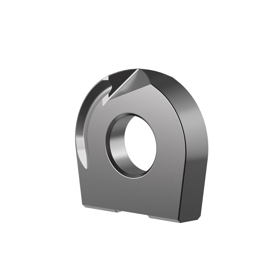

KDMB™ • Carbide Insert • KDMB-GC • Light Machining • Inch
Indexable Inserts
Material Number6784081
ISO Catalog IDKDMB0750M0ERGCANSI Catalog IDKDMB0750M0ERGC
- P Steel
- M Stainless Steel
- K Cast Iron
- N Non-Ferrous
- S High-Temp Alloys
- H Hardened Materials
| Material Number | 6784081 |
| ISO Catalog ID | KDMB0750M0ERGC |
| ANSI Catalog ID | KDMB0750M0ERGC |
| Grade | KCPH15 |
| [W] Cutting Width | 19.05 mm |
| [W] Cutting Width | 0.75 in |
| [S] Insert Thickness | 3 mm |
| [S] Insert Thickness | 0.1181 in |
| [RC] Corner Radius Center | 9.525 mm |
| [RC] Corner Radius Center | 0.375 in |
