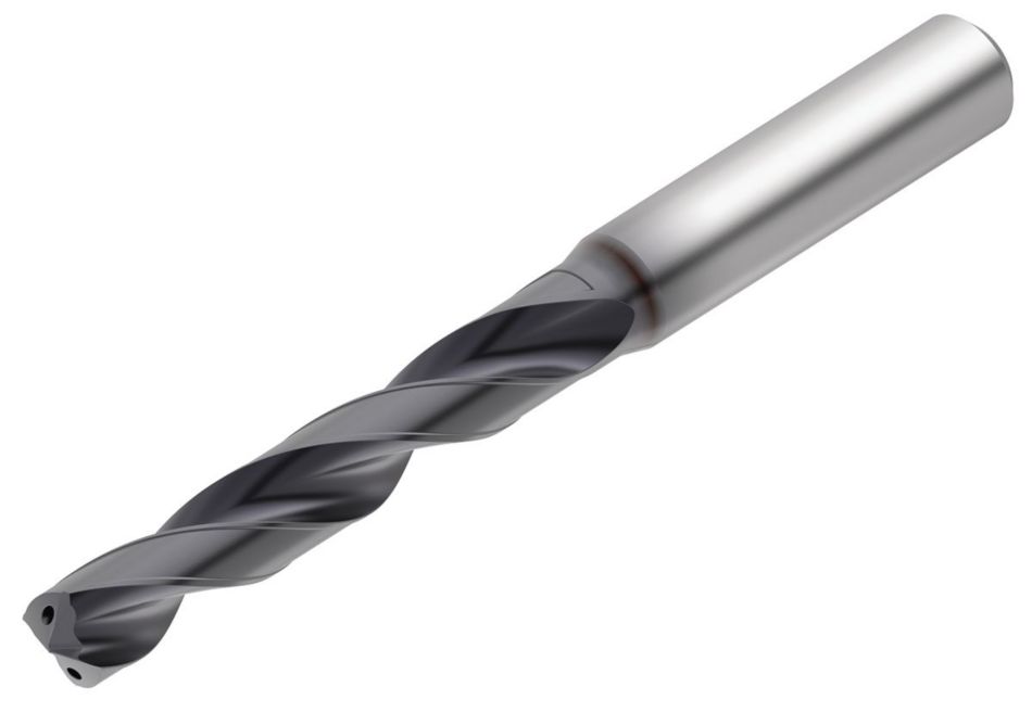

Kenna Universal™ Drill • 5xD • Internal Coolant • Straight Shank • Metric
Solid Carbide Drill for Universal Applications
Material Number1913596
ISO Catalog IDB977A11700ANSI Catalog IDB977A11700
- P Steel
- M Stainless Steel
- K Cast Iron
- N Non-Ferrous
- S High-Temp Alloys
Drilling: Stacked Plates
Drilling
Drilling: Inclined Exit
Tool Dimensions: 2flute/4margin/coolant
DIN number 6535
DIN number 6537
Drilling - Through Coolant
Through Coolant: MQL (Minimum Quantity Lubricant): Drilling
Shank - Cylindrical Plain ≤h6
Helix Angle: 30°
Drilling: Cross-Hole Drilling
| Material Number | 1913596 |
| ISO Catalog ID | B977A11700 |
| ANSI Catalog ID | B977A11700 |
| Grade | KCU15 |
| [D1] Drill Diameter M | 11.7 mm |
| [D1] Drill Diameter M | 0.4606 in |
| [L] Overall Length | 118 mm |
| [L] Overall Length | 4.6457 in |
| [L3] Flute Length | 71 mm |
| [L3] Flute Length | 2.7953 in |
| [L4] Maximum Drilling Depth | 56 mm |
| [L4] Maximum Drilling Depth | 2.2047 in |
| [L5] Drill Point Length | 2.01 mm |
| [L5] Drill Point Length | 0.0791 in |
| [LS] Shank Length | 45 mm |
| [LS] Shank Length | 1.7717 in |
| [D] Adapter / Shank / Bore Diameter | 12 mm |
| [D] Adapter / Shank / Bore Diameter | 0.4724 in |
- Steel
- Stainless Steel
- Cast Iron
- Non-Ferrous
- High-Temp Alloys
Drilling
DIN number 6535
DIN number 6537
Helix Angle: 30°
- Four-margin land design provides hole straightness and roundness, even when drilling cross-holes
- Low thrust drill point design offers excellent centering and is ideal for unstable machining conditions
- Easy to recondition, delivering extended tool life
- Versatile across various machines
- All shanks meet DIN 6535 and 69090-03 requirements for Minimum Quantity Lubrication (MQL)
