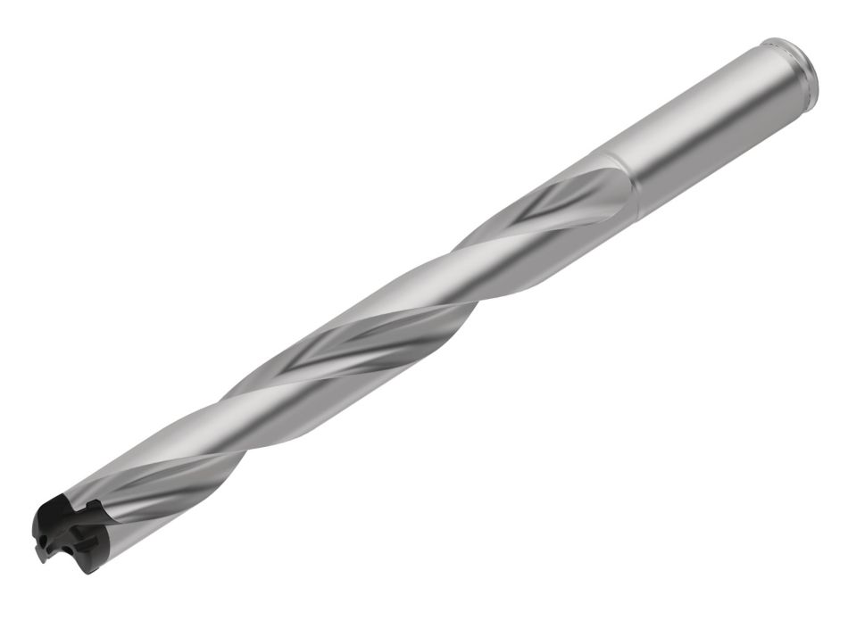

KenTIP™ FS • Drill Body • 8 x D • SS Shank • Inch
Modular Drilling • Straight Shank (SS)
Material Number6372057
ISO Catalog IDKTFS0414R08SS044ANSI Catalog IDKTFS0414R08SS044
- P Steel
- M Stainless Steel
- K Cast Iron
- S High-Temp Alloys
- .caption
Drilling - Through Coolant
Shank - Cylindrical Plain ≤h6
- Overview
- Application Data
- Downloads
- Spare Parts
| Material Number | 6372057 |
| ISO Catalog ID | KTFS0414R08SS044 |
| ANSI Catalog ID | KTFS0414R08SS044 |
| [D1] Drill Diameter M | 10.5 mm |
| [D1] Drill Diameter M | 0.4134 in |
| [D1MAX] Drill Diameter Maximum | 10.999 mm |
| [D1MAX] Drill Diameter Maximum | 0.433 in |
| [L4] Maximum Drilling Depth | 88 mm |
| [L4] Maximum Drilling Depth | 3.465 in |
| [L] Overall Length | 146 mm |
| [L] Overall Length | 5.748 in |
| [LATTH] Insert Attach LG Holder | 139.9 mm |
| [LATTH] Insert Attach LG Holder | 5.5079 in |
| [LS] Shank Length | 42.42 mm |
| [LS] Shank Length | 1.6701 in |
| [D] Adapter / Shank / Bore Diameter | 11.1125 mm |
| [D] Adapter / Shank / Bore Diameter | 0.4375 in |
| [SSC] Insert Seat Size | K |
- Steel
- Stainless Steel
- Cast Iron
- High-Temp Alloys
- .caption
- Large, ultra-high polished chip flutes guarantee hassle-free chip evacuation, enhancing tool life and performance.
- Coolant delivery to the drill point and to the rake face for guaranteed coolant delivery where it is needed.
- Every drill body comes with a KenTIP FS smart wrench. Insert exchange in the machine becomes easy and saves idle time and money.
