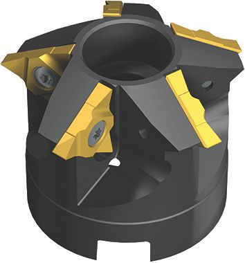

Material Number5593136
ISO Catalog IDKTMDUSD42L400Z4ANSI Catalog IDKTMDUSD42L400Z4
- P Steel
- M Stainless Steel
- K Cast Iron
- S High-Temp Alloys
- H Hardened Materials
- .caption
- Overview
- Application Data
- Downloads
- Spare Parts
| Material Number | 5593136 |
| ISO Catalog ID | KTMDUSD42L400Z4 |
| ANSI Catalog ID | KTMDUSD42L400Z4 |
| [D1] Effective Cutting Diameter | 42 mm |
| [D1] Effective Cutting Diameter | 1.6535 in |
| [D] Adapter / Shank / Bore Diameter | 16 mm |
| [D] Adapter / Shank / Bore Diameter | 0.63 in |
| [D2] Maximum Body Diameter | 34.5 mm |
| [D2] Maximum Body Diameter | 1.3583 in |
| [D6] Hub Diameter | 34 mm |
| [D6] Hub Diameter | 1.3386 in |
| [L] Overall Length | 40 mm |
| [L] Overall Length | 1.5748 in |
| [LF] Functional Length | 32 mm |
| [LF] Functional Length | 1.2598 in |
| [LFA] LF A Dimension | 7.8 mm |
| [LFA] LF A Dimension | 0.3071 in |
| Number of Inserts | 4 |
| Max RPM | 3430 |
