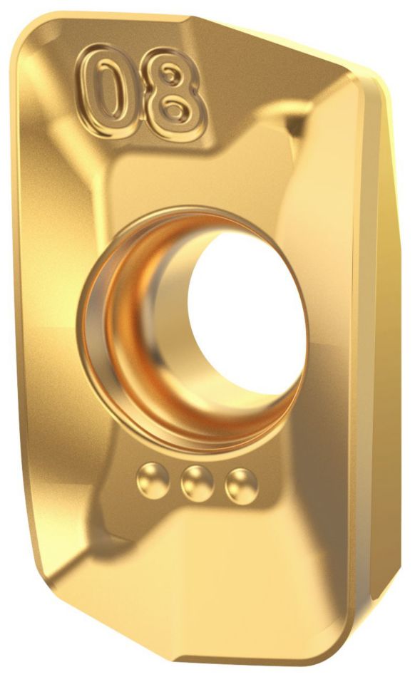

Mill 1-7™ • Carbide Insert • EDPT-GE • Light Machining
Shoulder milling insert with two cutting edges per insert
Material Number5545169
ISO Catalog IDEDPT070308PDSRGEANSI Catalog IDEP0708SGE
Mill 1-7 Carbide Insert - EDPT-GE - KCPM40 - EP0708SGE - 5545169 - Kennametal.com
GradeKCPM40
[LI] Insert Length 8.19 mm
[LI] Insert Length 0.322 in
[S] Insert Thickness2.8 mm
[S] Insert Thickness0.1102 in
[W] Insert Width 4.69 mm
[W] Insert Width 0.185 in
[BS] Corner Facet Length 1.7 mm
[BS] Corner Facet Length 0.067 in
[Rε] Corner Radius 0.8 mm
[Rε] Corner Radius 0.031 in
Average Chip Thickness [HM]0.085 mm
Average Chip Thickness [HM]0.0033 in
Cutting Edges per Insert2
KCPM40
KCPM40
Coated carbide grade with an advanced PVD TiAlN/AlCrN coating. Tough substrate with excellent capability at higher temperatures. KCPM40™ is the first choice for milling steel and stainless steel. Good thermal shock resistance makes this grade ideal for both wet and dry machining. Primarily for use in general and heavy machining.
  • Pressed-to-size, for lowest cost per cutting edge..
