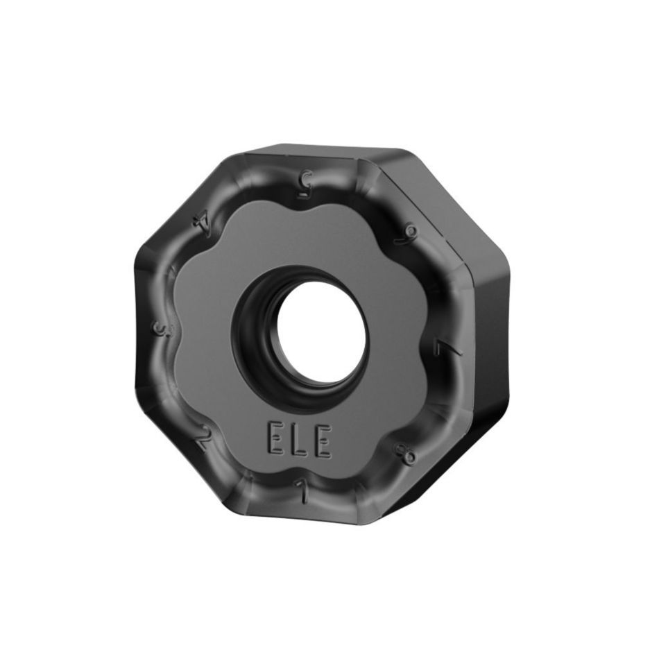

Mill 16™ • Carbide Insert • ONGX-LE • Light Machining
Face milling insert with sixteen cutting edges, precision ground.
Material Number6406706
ISO Catalog IDONGX080620ENLEANSI Catalog IDONGX645ENLE
- K Cast Iron
| Material Number | 6406706 |
| ISO Catalog ID | ONGX080620ENLE |
| ANSI Catalog ID | ONGX645ENLE |
| Grade | KCK15 |
| [D] Insert IC Size | 20 mm |
| [D] Insert IC Size | 0.787 in |
| [S] Insert Thickness | 5.81 mm |
| [S] Insert Thickness | 0.229 in |
| [L10] Insert Cutting Edge Length | 8.284 mm |
| [L10] Insert Cutting Edge Length | 0.3262 in |
| [Rε] Corner Radius | 2 mm |
| [Rε] Corner Radius | 0.079 in |
| Average Chip Thickness [HM] | 0.05 mm |
| Average Chip Thickness [HM] | 0.002 in |
| Cutting Edges per Insert | 16 |
- Cast Iron
KCK15
- Precision ground insert for best run-out and surface floor finish.
- Milling insert for cast iron and compacted graphite iron (CGI) machining.
- User-friendly handling with numbered insert cutting edges.
- Embedded wiper facet for improved floor finish.
- Inserts can be loaded in cutter bodies with screw or wedge clamping.
