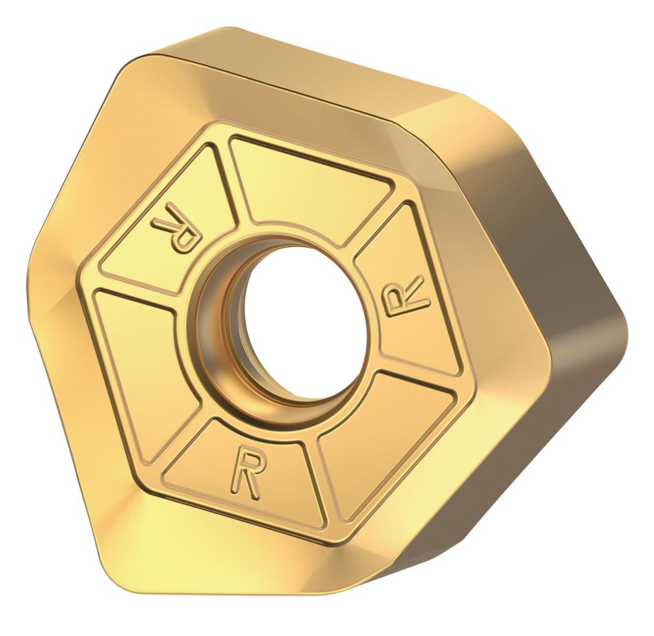

Dodeka™ 45° • Wiper Carbide Insert • XNGJ-GD3W • Fine Finishing of Multiple Materials
Face milling wiper insert, precision ground.
Material Number3547033
ISO Catalog IDXNGJ0905ANSNGD3WANSI Catalog IDXNGJ535ANSNGD3W
GradeKC725M
[D] Insert IC Size15.875 mm
[D] Insert IC Size0.625 in
[BS] Corner Facet Length 6 mm
[BS] Corner Facet Length 0.23 in
[L10] Insert Cutting Edge Length9.165 mm
[L10] Insert Cutting Edge Length0.3608 in
[Rε] Corner Radius 1.6 mm
[Rε] Corner Radius 0.063 in
[S] Insert Thickness5.509 mm
[S] Insert Thickness0.2169 in
Average Chip Thickness [HM]0.094 mm
Average Chip Thickness [HM]0.0037 in
Cutting Edges per Insert6
KC725M
KC725M
  • Wiper insert for excellent floor finish
