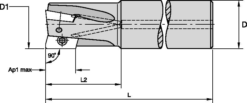

Drawings for 2613788
Material Number2613788
ISO Catalog ID32A02R050A32SED18-200
ANSI Catalog IDM1D032ME1802C032L050-200
[D1] Effective Cutting Diameter32 mm
[D1] Effective Cutting Diameter1.26 in
[D] Adapter / Shank / Bore Diameter1.26 in
[L] Overall Length 200 mm
[L] Overall Length 7.874 in
[L2] Head Length 50 mm
[L2] Head Length 1.969 in
[AP1MAX] 1st Maximum Cutting Depth17 mm
[AP1MAX] 1st Maximum Cutting Depth0.69 in
Number of Inserts2
Maximum Ramping Angle10.8
Weight Kilograms1.1
Max RPM32140
