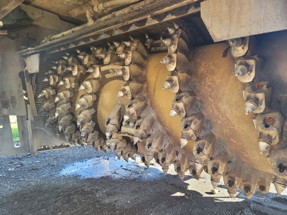

Road construction equipment is always facing challenges and the off-season is the perfect time for evaluating and replacing parts. Key components including tool holders (sleeves), kicker paddle edges, edge cutters, moldboard blades, and wear pads (skis) are common parts to inspect.
Common parts that you should inspect:

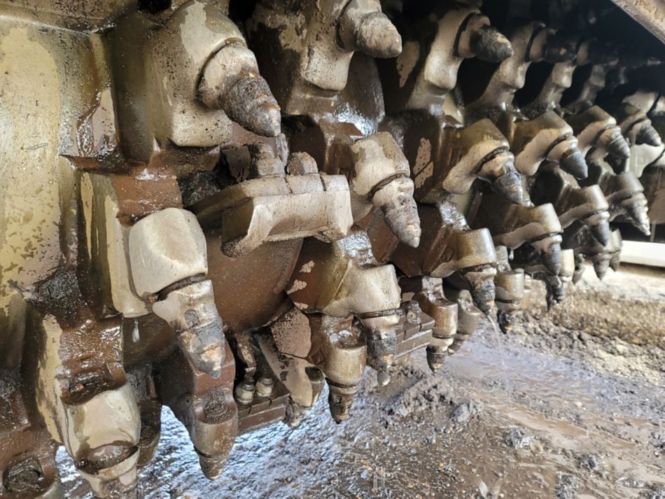

Sleeves: These can wear down due to rotation friction and exposure to abrasive conditions. You should look for cracks, chips, or excessive wear. Loose or worn sleeves and excess material build up will have a negative effect on the tool performance that can result in carbide flat spotting or fracturing.
Kicker Paddles/Plates: Used for lifting material within the housing, these paddles can experience wear, chipping, or stress during regular operation. Less effectiveness of kicker paddles increases wear on other components and reduces conveyance efficiency over time.
Edge Cutters: Essential for proper material movement within the housing. Ineffective use can lead to wear of the edge and result in an increase of unwanted energy consumption.
Moldboard Edges: Used for sealing the cut material in the housing. Hardened and wear-resistant materials for replacement edges can improve overall performance.
Ski Pads/Track Pads/Wear Pads: Designed to reduce friction and protect crucial components of the milling drum. Pads push the milling machining drum into the cut and if the pads are worn, they cannot create the force needed to push the milling drum which would affect the cutting system. Use high-quality, abrasion-resistant materials for replacement pads to significantly enhance the lifespan of the pads.
Worn out rotating PCD teeth on KPF 301 system.

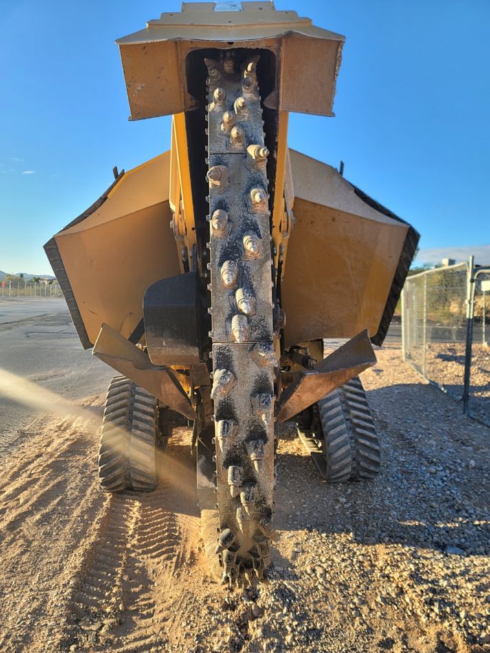

A small wheel trencher outfitted with Kennametal SM06 teeth.
