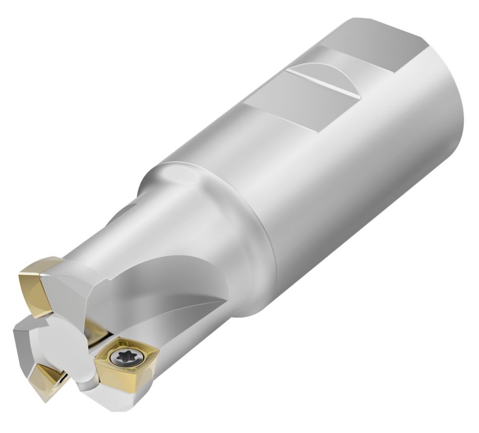

7792VXD09 Series • End Mill • Weldon Shank • Inch
High-Feed copy milling cutter for multiple materials.

| Material Number | 5658075 |
| ISO Catalog ID | C7792VXD09WA1.00Z2R |
| ANSI Catalog ID | C7792VXD09WA1.00Z2R |
| [D1MAX] Maximum Cutting Diameter | 25.4 mm |
| [D1MAX] Maximum Cutting Diameter | 1 in |
| [D] Adapter / Shank / Bore Diameter | 25.4 mm |
| [D] Adapter / Shank / Bore Diameter | 1 in |
| [L] Overall Length | 97.912 mm |
| [L] Overall Length | 3.8548 in |
| [L2] Head Length | 40 mm |
| [L2] Head Length | 1.5748 in |
| [AP1MAX] 1st Maximum Cutting Depth | 1.5 mm |
| [AP1MAX] 1st Maximum Cutting Depth | 0.0591 in |
| [Z] Number of Flutes | 2 |

- Internal coolant supply
- Positive design to support low cutting forces and applications with long overhang
