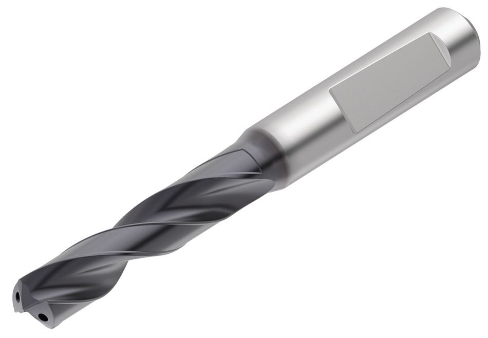

Kenna Universal™ Drill • 3 x D • Internal Coolant • Whistle Notch™ Shank • Metric
Solid Carbide Drill for Universal Applications
Material Number1913716
ISO Catalog IDB976F08000ANSI Catalog IDB976F08000

  • DrillingDrilling
  • Tool Dimensions: 2flute/4margin/coolantTool Dimensions: 2flute/4margin/coolant
  • DIN number 6535DIN number 6535
  • DIN number 6537DIN number 6537
  • Through Coolant: MQL (Minimum Quantity Lubricant): DrillingThrough Coolant: MQL (Minimum Quantity Lubricant): Drilling
  • Shank - Cylindrical Whistle Notch 2°Shank - Cylindrical Whistle Notch 2°
GradeKCU15
[D1] Drill Diameter M 8 mm
[D1] Drill Diameter M 0.315 in
[L] Overall Length 79 mm
[L] Overall Length 3.1102 in
[L3] Flute Length 41 mm
[L3] Flute Length 1.6142 in
[L4] Maximum Drilling Depth 29 mm
[L4] Maximum Drilling Depth 1.1417 in
[L5] Drill Point Length1.35 mm
[L5] Drill Point Length0.0531 in
[LS] Shank Length 36 mm
[LS] Shank Length 1.4173 in
[D] Adapter / Shank / Bore Diameter8 mm
[D] Adapter / Shank / Bore Diameter0.315 in
  • DrillingDrilling
  • A four-margin land design provides hole straightness and roundness, even when drilling cross holes.
  • The low thrust drill point design has excellent centering capabilities, ideal for less stable machining conditions (allowing the drill to work well on a variety of machines).
  • Easy to recondition, delivering extended tool life.
  • MQL-ready! All shanks fulfil the DIN 6535 and 69090-03 requirements for minimum quantity lubrication.
