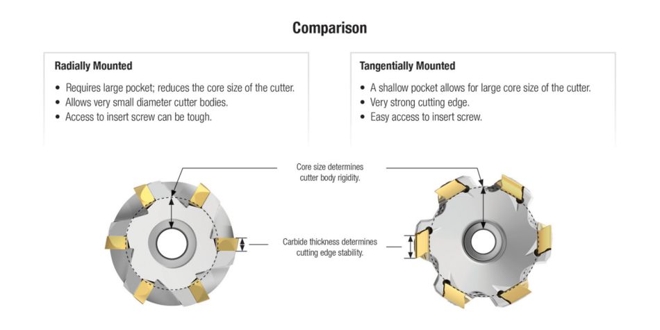

  • Mill 4-12KT requires up to 15% less horsepower, enabling increased feed rates, even on 40 taper machines.
  • The proprietary insert design — featuring a triangular shaped margin — provides unprecedented stability in steel and cast iron applications.
  • Excellent floor finishes due to minimal axial runout.

Comparison Of Radially Vs. Tangentially Mounted MILL 4-12KT Inserts
Higher MRR & Lower Tool Costs

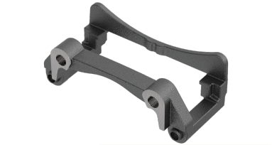

Challenge: Improve cost-per-part (CPP) by increasing productivity when milling a dry roughing to finishing application.
Solution: Mill 4-12KT
Results: Increased chip load per tooth for higher MRR and improved surface finish without compromising tool life. Mill 4-12KT also lowered tool cost due to less inserts per load and had better repeatability.
Read the full story
