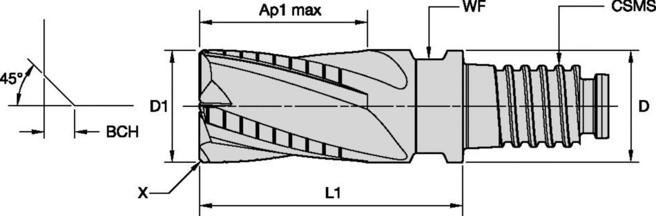

  • Helix Angle: 20°Helix Angle: 20°
Drawings for 6127419
Material Number6127419
ISO Catalog IDRQDB1000Y5CV
ANSI Catalog IDRQDB1000Y5CV
GradeKCPM15
Adapter Style Machine SideDUO-LOCK
[D] Adapter / Shank / Bore Diameter24.4 mm
[D] Adapter / Shank / Bore Diameter0.9606 in
[L1] Gage Length57.2 mm
[L1] Gage Length2.252 in
[CSMS] System Size Machine SideDL25
[WF] Width of Flat 21 mm
[WF] Width of Flat 0.8268 in
[BCH] Corner Chamfer Width 0.5 mm
[BCH] Corner Chamfer Width 0.0197 in
[Z] Number of Flutes5
[D1] Effective Cutting Diameter25.4 mm
[D1] Effective Cutting Diameter1 in
[AP1MAX] 1st Maximum Cutting Depth38.1 mm
[AP1MAX] 1st Maximum Cutting Depth1.5 in
KCPM15
KCPM15
  • Center cutting.
  • Cord profile reduces machine power consumption.
