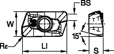

Drawings for 3684828
Material Number3684828
ISO Catalog IDEDCT10T331PDERLD
ANSI Catalog IDEC1031ELD
GradeKC725M
[LI] Insert Length 11.516 mm
[LI] Insert Length 0.4534 in
[S] Insert Thickness3.75 mm
[S] Insert Thickness0.148 in
[W] Insert Width 6.714 mm
[W] Insert Width 0.2643 in
[Rε] Corner Radius 3.1 mm
[Rε] Corner Radius 0.122 in
Average Chip Thickness [HM]0.038 mm
Average Chip Thickness [HM]0.0015 in
Cutting Edges per Insert2
