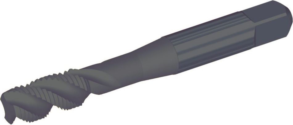

T832 • Form E Bottoming Chamfer • Machine Screw and Fractional • ANSI
GOtap™ T832 Spiral-Flute HSS-E Taps • Blind Holes
Material Number5443856
ISO Catalog IDT832NC05625-12RH3-AANSI Catalog IDT832NC05625-12RH3-A
SFT BOTT DIN Inch Threading - 5443856 - Kennametal
$168.56/each
  • Chamfer Form E (1.5–2)Chamfer Form E (1.5–2)
  • 3861838618
  • Manufacturer’s Specs: UNFManufacturer’s Specs: UNF
  • Manufacturer’s Specs: UNCManufacturer’s Specs: UNC
  • Tapping Helix Angle: 45°Tapping Helix Angle: 45°
Drawings for 5443856
GradeKSP39
[D1-TDZ] Thread Diameter Size9/16 - 12
[L] Overall Length 91.2 mm
[L] Overall Length 3.59 in
[L3] Thread Length 25.4 mm
[L3] Thread Length 1 in
[L2] Useable Length 44.2 mm
[L2] Useable Length 1.74 in
[D] Adapter / Shank / Bore Diameter10.897 mm
[D] Adapter / Shank / Bore Diameter0.429 in
[Z] Number of Flutes3
Tap Pitch Diameter LimitH3
  • 3861838618
KSP39
KSP39
HSS-E substrate with black oxide surface treatment. Use in a variety of materials, including steel, stainless steel, and ductile iron. Not recommended for non-ferrous materials.
