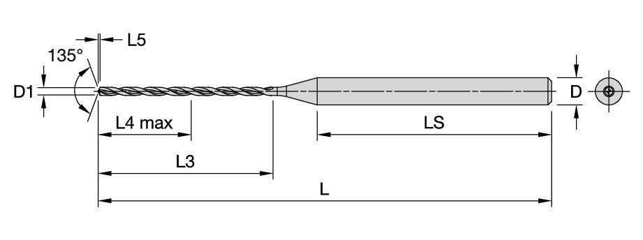

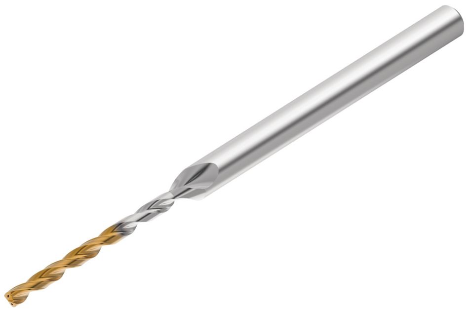

KenDrill™ Micro • 12 x D • Internal Coolant • Straight Shank • Metric
Solid Carbide Deep Hole Drill for Small Diameters in Multiple Materials
Material Number102833049
- High coolant volume supply ensures efficient chip evacuation.
- Micro drilling of short and deep holes on swiss style lathe or machining centers.
- Drilling
- Tool Dimensions: 2flute/4margin/coolant
- Drilling - Through Coolant
- Shank - Cylindrical Plain ≤h6
- Helix Angle: 30°
