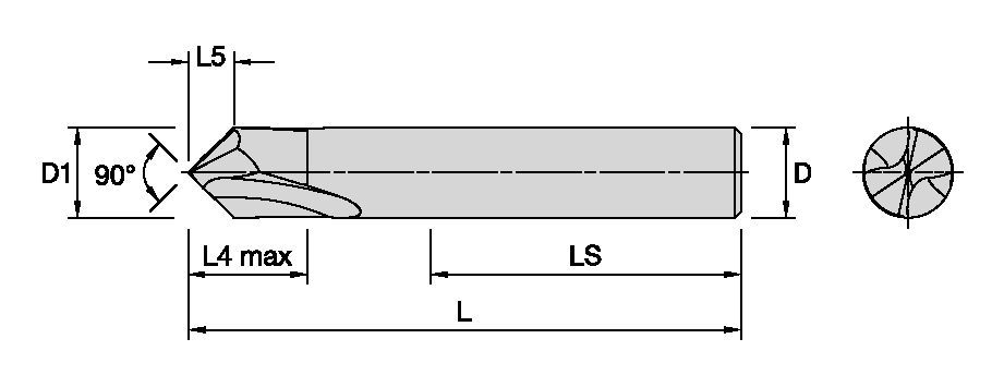

Drawings for 1191631
Material Number1191631
ISO Catalog IDB505Z12000
ANSI Catalog IDB505Z12000
GradeK10
[D1] Drill Diameter M 12 mm
[D1] Drill Diameter M 0.4724 in
[L] Overall Length 73 mm
[L] Overall Length 2.874 in
[L4] Maximum Drilling Depth 14 mm
[L4] Maximum Drilling Depth 0.5512 in
[LS] Shank Length 52 mm
[LS] Shank Length 2.0472 in
[D] Adapter / Shank / Bore Diameter0.4724 in
